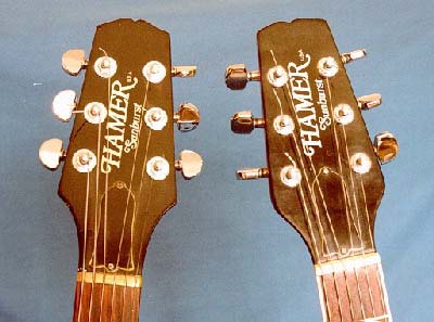

The neck was carved from a single piece of mahogany with a long and elegant angled-back headstock with a pronounced "lip" or "open-book" shape at the top. Grover "kidney-button" tuners were usually fitted and on the earliest guitars these have bull's-eye backs rather than a smooth back cover. By the end of 1978 the Sunburst was beginning to evolve. The wooden shim and bridge were replaced by a purpose built bridge milled out of solid brass and chrome plated although the same pattern saddles continued to be used. The long style of headstock was modified to have a shorter distance between the nut and the first tuner giving a more squat appearance. The phenolic back-plate found on the earliest Sunbursts was replaced by a stamped aluminium backplate. The pickups were wired out-of-phase electrically an all but the earliest Sunbursts, as the early DiMarzio PAFs had a single conductor wire and shielding (which was used as the ground conductor). The photo. below shows the difference between an ea
Sunburst HeadstocksNote that the left headstock (1978) is longer and has a more pronounced "lip" shape at the top compared to the 1982 example on the right. Also note that Schaller machineheads have replaced the kidney-button Grovers.

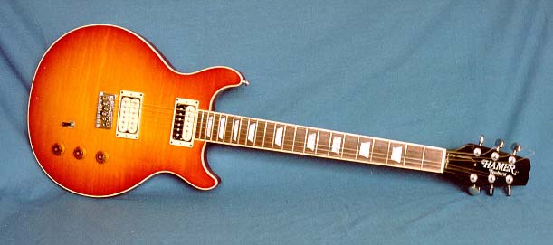

1982 again saw more new Hamer models - the Blitz guitar and bass, the CruiseBass and the Phantom. All these models were numbered along with the Sunbursts whilst the Standard, Eight- and Twelve-string basses and other custom instruments kept a separate system. Numbers are hard to estimate but as the range of Hamer models increased, the number of Sunbursts made must have dropped. Fashion was changing and the Sunburst with its ultra-traditional design was no longer in favour. 1983 and 1984 saw Hamer aim successfully for the rising Heavy Rock market with wild finishes, locking trems. and angular body shapes - although a few must still have been built it looked like the Sunburst story was over.
1982sunburstA 1982 Sunburst - Crown Inlays
