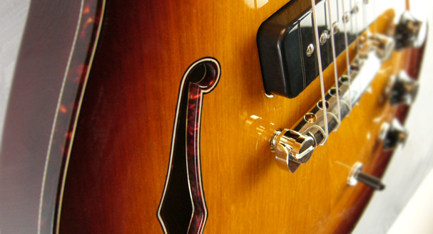

Did you think of the stacked binding, because I don't think anyone has ever done that before.  Must have added serious $$$$ to the C/O.

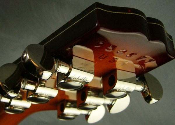

Yes, it was my idea. I thought tort binding would blend really nicely with jazzburst, but I wanted both the top and side with a multi-ply to make it pop a bit.
I explained it to BCR Greg, and he knew exactly what we needed. I had never heard of "stacked purfling" before, but I had seen acoustics with it before.
Greg worked some magic with the shop to get this done. The anniversary inlays were a tough sell, and note that the f-hole has the binding stacked as well. I still have no idea how they did that.

It's truly an amazing build.  And yes, I noticed that they did it to the f-hole as well, which must have been incredibly tedious and hard to do.  It's something you'd expect from the late great John D'Angelico

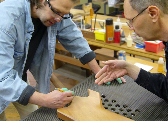

A few hours later, Mike has cut the neck pocket and fitted the neck to the body of the guitar. He's added the bevels on the body, and now it's time to do the neck blending. The first step is to draw out the blend line on the instrument. The idea here is to provide good hand access, retain the maximum amount of joint for good energy transfer and create a pleasing visual transition.
After Mike and I take a couple swipes at it we get a good line, so it's time to park the guitar in a vise and get after it with a pneumatic drum sander. The grit is very coarse, so Mike takes it easy, just hogging off the major real estate. In this photo you can see the wood flying off the sander past Mike's shirt—always wear eye protection!
After the sander, Mike does the final smoothing with a file and then with sandpaper. After about an hour, it's looking good.

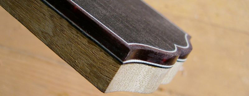

A lot has happened with Glenn's guitar in the last few weeks, so we'll try to catch up. We decided to keep the traditional "GT" headstock on this model, and because Glenn wanted bevels on the body we thought that the headstock should echo that too.
After Mike sketched the first draft, I put a logo overlay on the headstock to see how the whole thing would look. When we saw the overall effect, I thought that the bevel was too large. It really dominated the headstock as opposed to being a flourish like the ones on the body; so we reduced the mass of the bevel to suit the overall theme. It's important to think of the instrument as a whole rather than a collection of individual design ideas because no matter how much you like them all, if they don't work together the design fails.
Satisfied that we'd balanced things out, Mike proceeded with the woodworking using a sander, file and a scraper. Then it's just a matter of prepping for the paint room where we'll pick it up next time.
