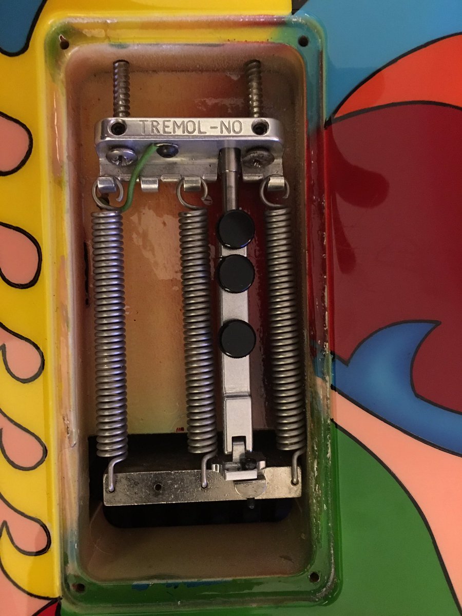

Dasein Posted July 17, 2016 Author Posted July 17, 2016 Do you guys have any specific recommendations or part numbers for the heli-coils for stripped saddle screws? Now obviously there's a certain amount of labour in drilling out the plate and installing the heli-coil (I assume a drill press is needed or can I just hand drill this?) -- would it be better just to get a new base plate? Also - as you can see from this shot, with my tremol-no installed the clearance of the spring on the one side of the cavity is just not enough - it sometimes touches by a hair so I'm thinking of drilling a new spring hole just a few mm over -- is now the time to consider a new block altogether. I think these are 37. What makes a good or better block? I just hate intonation issues -- do you guys use a formula of offsets at all for Floyds or is it strictly 12th fret harmonic to fretted note?
