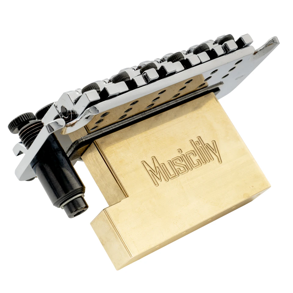

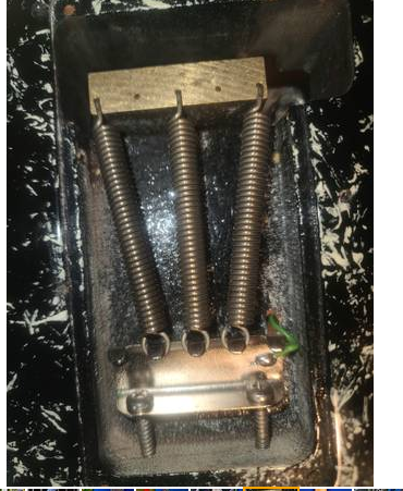

Also this OFR comes with mounts, screwed directly into the wood. I wonder, if he replaced original Schaller mounts with those.
What is that?
No. And Floyd rose upgrade doesn’t make sense, the cavity is to small for it. He should have put Schaller FR instead

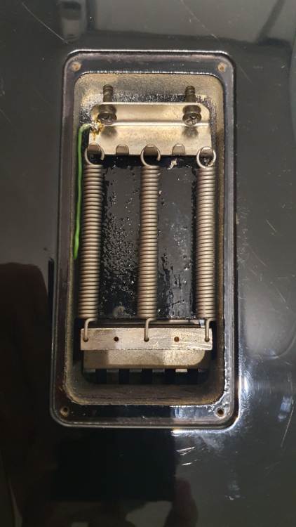

That Californian is mine. Let me explain what is going on and maybe someone can help me with some advice. I bought this guitar at a pawn shop a few years back. Someone had removed the original Floyd and replaced it with a non-floyd (Kahler I believe) they also replaced the pickups and removed the back cover. I had the 1984 Floyd put in. I asked again and was told this:
The Bridge Mounts: To clear up the main concern—the original factory metal bushings/inserts are fully intact. The tech did not use wood screws; the 1984 Reissue is mounted to the original-style studs. No structural holes were filled or redrilled.
The Cavity/Block: The German 1984 Reissue’s brass block and screws have full clearance in the factory routing. No wood was removed to make it fit.

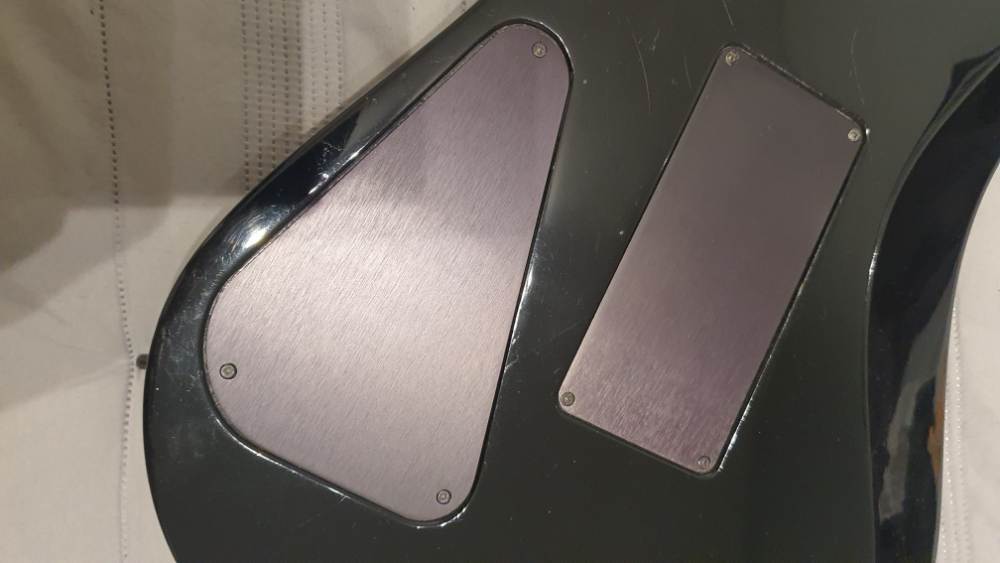

Also I put that back cover on there. I am going to try to find the correct sized plate. Below is a picture of the open cavity in the back. Please let me know if I am correct on all this. Thanks
The additional routing under the trem looks like it could have been for one of FR's L-shaped blocks.
Still don't quite get why folks put on a standard OFR with the stock string bolts that extend over the pull up rout. I guess if you don't pull up on the bar at all it still likely flutters and certainly dives.
